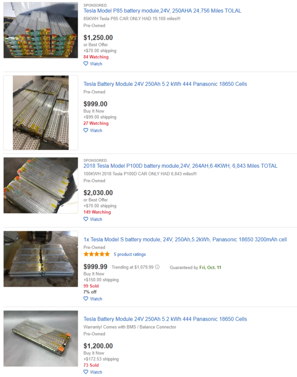

Dan Hedin Posted October 5, 2019 Author Share Posted October 5, 2019 I looked on Ebay to see what battery packs were going for. It looks like the prices are very high around $1k-$2k per module so there must be a lot of demand. 2 Quote Link to comment Share on other sites More sharing options...

Dan Holtz Posted October 7, 2019 Share Posted October 7, 2019 While there is some demand for the batteries, I personally think it is less than the price identifies. They have always floated around the $1200-$1400 range but you can sometime get a full pack for a good discount. I picked up an 85kwh pack for 7k plus about $400 in shipping. There are a few people that have setup "powerwalls" using the bricks, it's non trivial as they run at a bit different voltages then most systems are expecting but I would say the most notable creation is wk057's https://teslamotorsclub.com/tmc/threads/plan-off-grid-solar-with-a-model-s-battery-pack-at-the-heart.34531/ I created my own a few years ago and used it for load shifting but my current line of thinking is pointing me towards using model 3 packs with my next build. 1 Quote Link to comment Share on other sites More sharing options...
mike Posted October 8, 2019 Share Posted October 8, 2019 On 10/5/2019 at 12:18 PM, Dan Hedin said: I looked on Ebay to see what battery packs were going for. It looks like the prices are very high around $1k-$2k per module so there must be a lot of demand. Or just very low supply. That's my guess at least. Quote Link to comment Share on other sites More sharing options...
